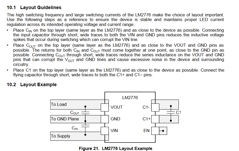

Hi I am running 4 lmp8350 at +-5V from a 5V supply and -5V from the lm2776.  One minute it is working appropriately, the next I am getting positive voltage from the negative output.  It is either 1.8V or 0.6V.  I have replaced them multiple times.  When I solder a new one on it works appropriately for awhile.  I have (2) 2.2uF caps at Vin and Vout and 1uF flying cap.  I have seen another post ()and should note that my Vin Vout caps are to the ground plane not directly to pin 2.
