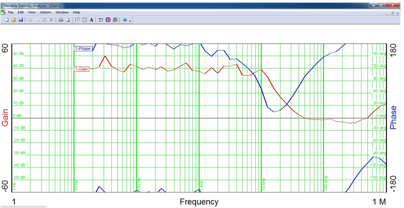

As following picture, The D-CAP2 haven’t Gain. Phase can’t cross 0 deg.
My customer want to know how to do explain this waveform??

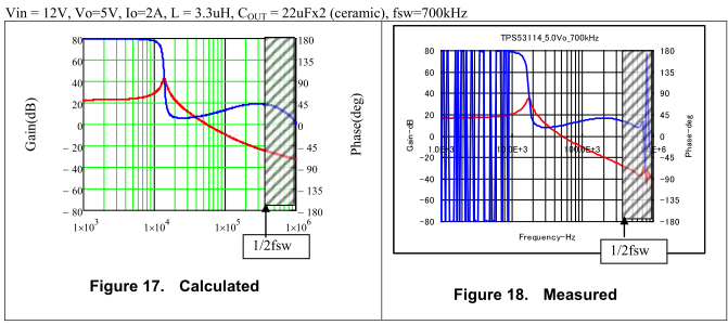

As SLVA546 application report:

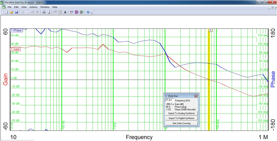

Following picture is measure result.
