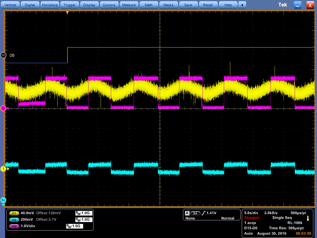

  • I realized that the ISET pin mirrored the output current, so I was able to capture the observed behavior on the scope.
    Channel 1 (yellow) is the input voltage, which is right about 5 V. Channel 2 (blue) is the output voltage, which is very close to 4.2 V. Channel 3 (magenta) is ISET, which has a gain of 1.51 V/A given that I have a 536 ohm resistor. D0 is the nCHG output.
    From this graph, it looks like the output is turning on and off due to thermal limiting. However, the nCHG output goes high even though the device is continuing to charge.

  • The following scope capture shows the BQ24040 operating more or less normally. nCHG on D0 is held low, and it appears that the temperature TS (yellow channel) is going up and down causing the current ISET (magenta channel) to turn on and off. The blue channel is the battery voltage. Note the offsets applied to the channels.

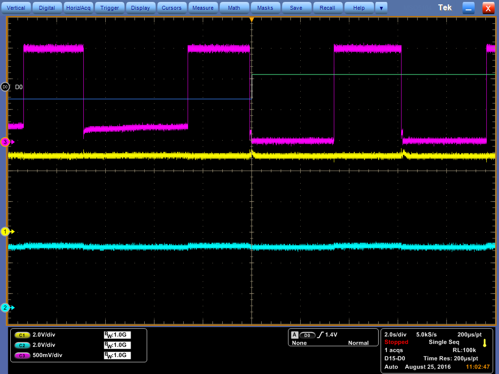

    The next scope capture shows the point in time when the nCHG (D0) channel goes high. Even after this happens, the charging operation appears to continue exactly as before.
    During charging, my device's main outputs are off, however a number of indicator LEDs are run off of a microcontroller. There is an LED drawing approximately 20 mA max which is pulsing in and out via PWM, and a Red/Green LED drawing up to about 5 mA (not pulsing, but mixing red/green with a PWM).
  • It's almost as if it is entering TDDM (causing  nCHG to go high, but charge current still flows. A battery detect sequence  is then run), and then not detecting your battery.
    Can we:
    • verify that the battery connection is solid (it probably is, but doesn't hurt to check)
    • Measuring the DC voltage at the TS pin while this is happening.
    • Try placing a 250k resistor from TS to ground. This  will disable TDDM, and let us rule that out

    I placed a 250k resistor in parallel with the thermistor, and my test showed basically the same thing. I have oscilloscope captures, but they are basically the same as the prior ones so I don't think it will be useful.
    I also just ran a test with a 10k resistor replacing the thermistor altogether. It looks like that test concluded without any issues, suggesting that the problems do in fact arise from the TS functionality. Luckily, on the next revision I'm moving the thermistor onto the microcontroller so I have temperature readings during both charge and discharge. TS will have a 10k resistor and I'll be enabling and disabling by switching the output pin between high impedance and ground. If I disable the charger in this manner, and then re-enable when the temperature drops back to a safe level, will the nCHG pin be pulled down again?

    Do you have the datasheet for the thermistor? It is not likely, but I'm curious if that was the problem. It is odd because your TS pin voltage is so low - which would indicate that the temperature is high.

  • We were using a Murata NCP15XH103F03RC. It's B value is basically exactly the same as the parts specified in the BQ24040 datasheet. Make sure that you account for the offset applied on the oscilloscope when reading the TS voltage - there's an extra 120 mV in there, which I needed to be able to get the resolution I wanted.
