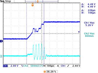

We use the TPS61240 Vin:2.5V and Vout: 5V to measure the output inrush current with Cin: 2.2uF and Cout: 4.7uF.
The test result show as below.
You can see the Transient Response (enable) the Iout go to almost 860mA then down to 0A
Why the current limit doesn't work?
What value is our maximum recommend Cout?
What sequence are recommend for En and Vin?
Does this inrush current damage TPS61240?
