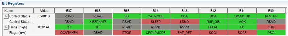

If I look at the data block summary for the BQ27425 it shows the Update Status register to have a default value of 0x34.
I'm trying to go through a learning cycle of my battery and I'm finding that it's stuck at this value.  Should it get reset to 0 before going through the procedure?  It's confusing because so much of the learning cycle documentation talks about IT_ENABLE and QEN, which I don't think this gauge has.  Is there something else I need to do before I start the charging and relaxing step, waiting for UPDATE_STATUS to equal 1?
I have log files that I can attach of my charging and relaxing steps if that would be helpful.  Thanks.
