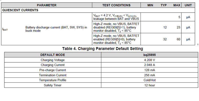

Hi sir,
May I know BQ25895 as below question, thanks.
1. BQ25895 How to get minimum quiescent current when Battery discharge?
2. What high Z status?
3. If not use I2C function, we can use default setting?
  • The charger automatically enters High Z = sleep mode when the input voltage is removed from VBUS. You can always enter High Z using the High Z. The lowest Iq state is when there is no VBUS and the BATFET connecting SYS to BAT is turned off (disabled). You can use the default settings if no I2C communication is available.
