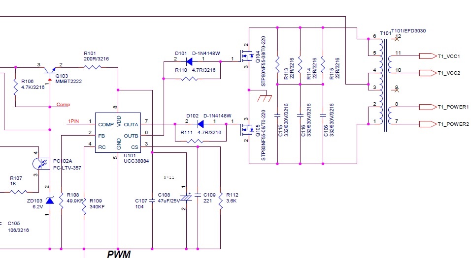

Customer is designing 380VDC output based on UCC38084 for input of inverter as below.
When they used 30W, it works good but when they increased output to 100W, inverter output signal was distorted.
Is it related source or sink current?
Could you recommend proper IC? Is UCC25600 proper?
