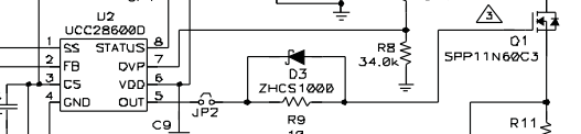

I am exploring the UCC28600EVM-65W and found below questions where need your help to clarify.

Q3. What is the function of below circuit? And how it work? (from EVM)

    About Q3: The UCC28600EVM design provides several options for experimentation in the feedback control. The EVM is configured to regulate one output at 18 V (OUT1), but it has provisions for a second output (OUT2) and place-holders to populate these components by the user if one so chooses. The unused winding has a 16:1 turns-ratio with the primary, so it is apparently intended for a low voltage output, but I don’t know specifically what level; possibly for 5 V. Feedback components R19, R20 and R24 provide a means to re-direct regulation from the 18-V output to the unused output. R24 would connect the bias current path for the TL431 to OUT2, and R13, D7 and C22 (which provide the TL431 bias from OUT1) would be depopulated.
