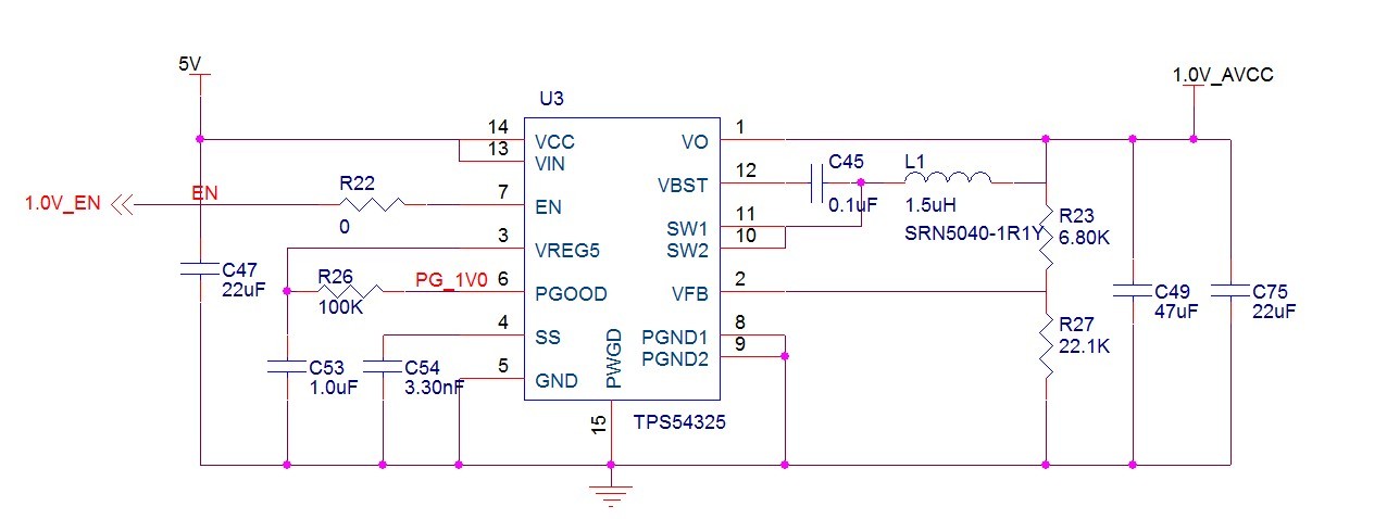

I need some advice about the layout of the TPS54x25 switcher.
Assuming it's a 4-layers board, and the layer arrangement is: Top -- GND -- Power -- Bottom.
schematic:

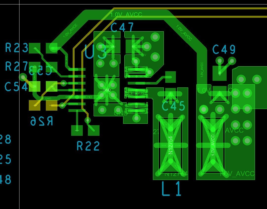

layout:
1. about the layout of the output voltage signal connecting to the high side of voltage feedback resister,  that is R23 in schematic.
   I use a wide wire connecting R23 to the power polygon of the switcher output.
   My question is :
   Is it better that i directly place a via near R23 through to the bottom plane if the the power plane below the switcher and R23 is an integrated 1.0V_AVCC plane ?
2. about the layout of the ground signal connecting to the lower side of voltage feedback resister,  that is R27 in schematic.
   As the guidelines recommended, I use a wire connecting R27 to the signal ground pin of the switcher, and then connecting to the PGND.
   My question is:
   Is it NOT preferable that i directly place a via near R27 through to the PGND plane?  The second layer is PGND plane.
This may be a little fussy, but i'm curious to know.
