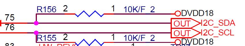

  • 1) About the pull-up resistors, they are 10K ohm.
    1-1) About the details, please refer to the picture below (I2C_bus_pull-ups.jpg).
    2) About the total capacitive load on the I2C bus, please refer to the picture below (I2C_bus_bq27421.jpg).
    2-1)  The I2C_SCL and I2C_SDA connections are connected to the SCL and SDA pins of bq27421 directly.
    3) About the "pull-ups are not strong enough" issue, do you mean that we should reduce
    the value of pull-up resistors to higher the I2C rising edges?
    For examples:  reduce to 5K ohm.
    4) Is it useful for this issue if reducing the frequency of I2C bus to 100KHz?
    Thank you.

  • If you want to use 400kHz SCL then you should reduce the pull up resistors. See http://www.ti.com/lit/an/slva689/slva689.pdf for more details.
    1-1) There are 3 I2C slaves on the I2C-bus of the current PCB Assembly as follows:
    >> TI BQ24295, TI BQ27421, and NXP PCA9551
    1-1-1) The TI BQ24295 and NXP PCA9551 worked fine on 400KHz and 10K ohm pull-up resistors.
    1-1-2) We changed the pull-up resistors to 5K ohm, and the SubCommands of TI BQ27421 cannot be accessed on 400KHz.
    1-2) Are the "Pullup Resistor Calculation" in the "I2C Bus Pullup Resistor Calculation" document applicable for all the 3 I2C slaves
    or only for TIBQ27421?

  • 1: The document that I linked to applies to all devices on the I2C bus. However, the bq27421 has additional timing requirements between packets if you use 400kHz SCL. Check the datasheet for further details (esp. the 66us bus free time and the single packet restrictions for SCL > 100kHz).

    The BQ27421 gauge works on 100 KHz (the frequency of I2C-bus) in the product now.
    And we are customizing the driver and debugging the 400 KHz issue in the product.
    Please do us a favor to close this case.
