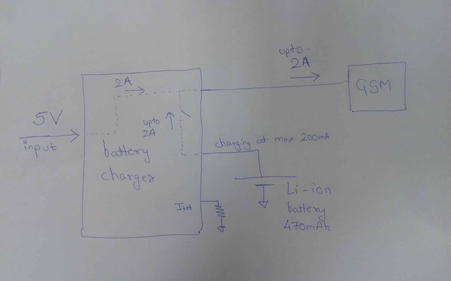

hello Team
Recently I came across an opportunity at one of my customer VVDN where they are trying to make a vehicle tracking system
The power source in this system will be a car battery , however they are using a bulk regulator to make 5V ,  have shown the system requirements below
The system should be able to stand alone ,( R settable )                           ( i2c host not present in the system )
I was not able to navigate to the right part due to the limited number of options in filtering the parameters
Please let me know if we can suggest any part here
Thank you so much
  • Hi Shreenidhi,
    You may want to look into the bq25890 charger.  EDIT: the bq24266
    One thing to take note : you are asking for 2A from a 470mAh battery, You will want to make sure the discharge rating is at least 4.5C or your battery will overheat.
