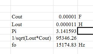

I am designing a charger controller using the bq24650 and using the evaluation board bq24650EVM as a guide for the layout. In the datasheet of the  bq24650 it says that the fo (resonance frequency) must be of 12 khz -17 khz. The evaluation board uses a 10uH inductor and two output capacitors, one of 10uF and another of 1 uF. The resonance frequency with this values are of 7.7 kHz. How can this work and why the evaluation board have this values? there is something I am missing? Thanks!
