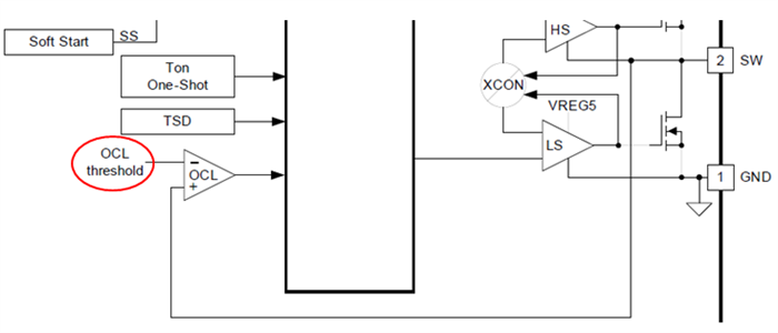

Could you please let us know the threshold of OCL level?

  • Hi Kanemaru-san,
    I did not get the actual data from our designer team. But I figure out a way to get a rough estimated current limit level. The OCL function detects the valley inductor current. The current measurement method for inductor current is using low side MOSFET Rdson(72m ohm). The inductor current flowing thru low side MOSFET will generate a negative voltage on SW pin( IL*Rdson), this voltage will compare with the OCL threshold to determine when the current limit will start to work. In this case, no matter what kind of inductor, if the OCL threshold is a fixed reference, the valley current limit level will be the same under all working condition. We could use current limit Iocl in the datasheet( output current) with the input, output and inductance to calculate the valley current level( Iocl-1/2*inductor ripple). With this valley current level, we could add a new half inductor ripple under a new working condition. I think in this case, we could get an estimated current limit value under other working condition.

  • Hi Anthony-san,
    Thank you for your prompt reply.
    I understand that "A" and "B" are the different OCL threshold.
    A: OCL threshold = IL/Rdson(72mohm) for TPS562209
    B: OCL threshold = IL/Rdson(39mohm) for TPS563209
    Therefore, I believe that I can’t compare "B" with "A" only with the inductor value.
    Is my understanding correct?
    Kanemaru
  • Hi Kanemaru-san,
    Yes, maybe you are correct. Since I am not the editor of this datasheet and it is not well explained, I did not figure out it is not for the same IC. Your understanding is more reasonable. But I still hold my idea on the current limit calculation.
    In datasheet, there is a sentense:"The load current is higher than the over-current threshold by one half of the peak-to-peak inductor ripple current." Since our current limit method is based on detecting the valley inductor current. Only if the valley current is higher than the OCL threshold, then our current limit will work. In this case, the valley current level that will trigger the current limit function will be an constant no matter what kind of working condition it is. But if the valley current reach the OCL threshold, the inductor current or the current limit level will depends on the working condition. This current limit level will be higher if the current ripple is higher, which is what I meant in the previous posts.
