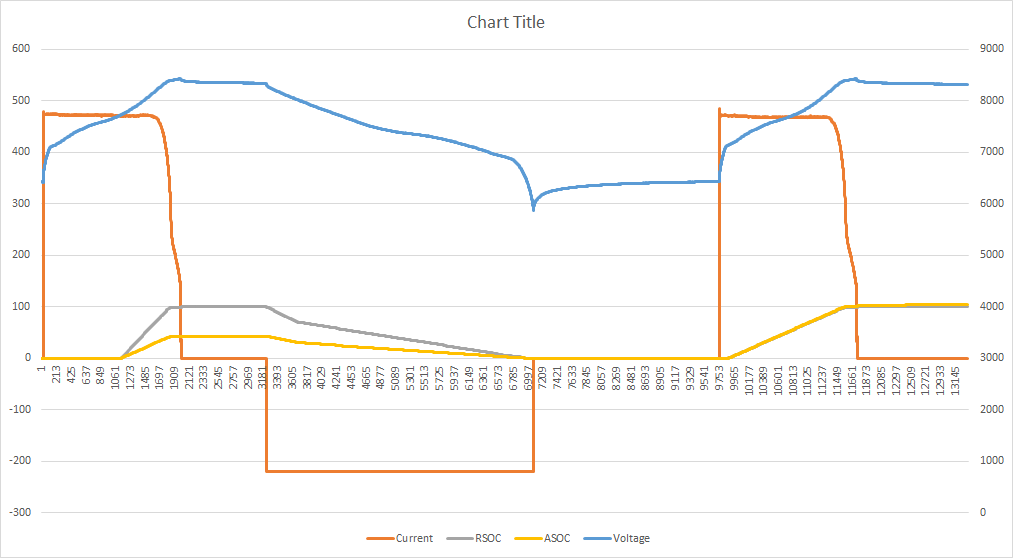

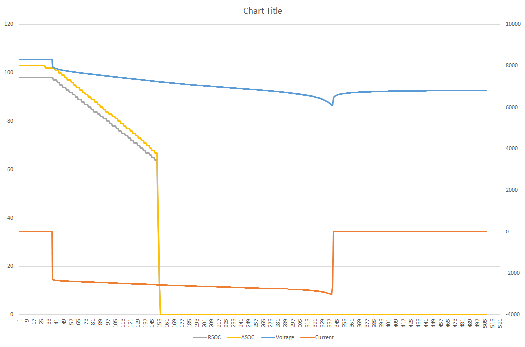

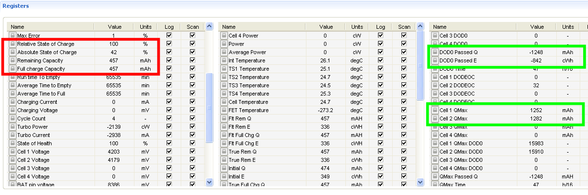

    I did more testing and it seems the problem is caused by the incorrect remaining and full capacity parameters.
    The DOD0 and QMax look perfectly alright. It also charges until FC is set and discharges until the min battery voltage is reached.
    What am I doing wrong?
    This shows a C/2 charging, C/5 discharging and another C/2 charging cycle:
    This is a 18W constant power discharging cycle which followed the last charging cycle above.(Gauge set in Load Mode 1 (LDMD flag =1)
