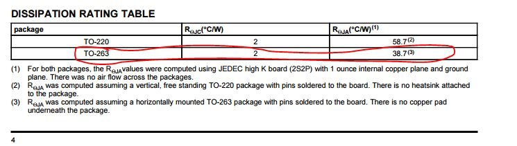

We are using "TPS75618KTT" LDO for generating 1.8V from 3.3V. Load current is 1A.
Couldnt find thermal resistance value for this device from datasheet. Please help us in getting this informaiton.
