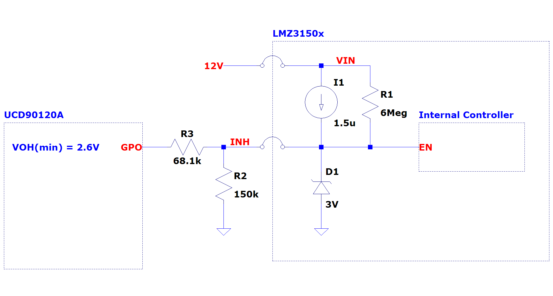

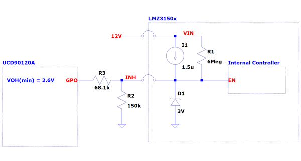

The LMZ31503/6 simple switchers are enabled by default, but in our application they must have their outputs disabled by default.  They will be sequenced by a UCD90120A power monitor, but there is a time when power is applied to the LMZ device but the sequencer does not yet have power and so cannot guarantee to have the LMZ inhibit pin pulled low.
Essentially what my question boils down to is if there is a suggested approach to making the inhibit pin act as an enable pin instead?
Or, how can I ensure that the output is disabled until explicitly commanded to be enabled by the sequencer, regardless of the power state of the sequencer?
