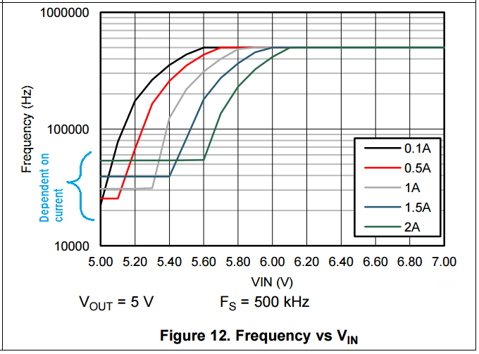

LM43602 supports low dropout operation by frequency foldback.
The eventual (low end) frequency seems dependent on the current as shown below.
What does determine the eventual frequency?
Thanks.
Oguri (TIJ automotive FAE)
  • The minimum frequency is determined by the internal oscillator. It is designed at about 1/8 of the RT frequency.
    -Yang
  • Hi Yang,
    I am afraid that is not an answer to my question. My question was why that is not always 1/8, and depending on the load current.
    Oguri
  • It could come from the operation near dropout condition. With peak current mode control, the HS switch is turned off by (Sensed inductor current + slope compensation) >= current command. At the boundary of dropout, the current command should be at its maximum value, regardless of load. Slope compensation value is propotional to Ton. With higher load current, the sum of (Sensed inductor current + slope compensation) reached current command max value at lower Ton. With lower load current, since the DC current is lower, it allows longer Ton by the peak current mode control loop, thus the minimum frequency is lower than higher current conditions. I hope this answers your question.
