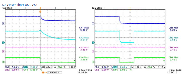

Customer is doing some test to short VBUS with USB/D+ on purpose, and this will generate a 3.6V @ VR3 output.  If I understood it correctly, it will cause VR3 fault, and trigger emergnecy shudown.  After the 3.6V is removed from the board, customer can see VR3 back to normal.  (LDO3V as ENVR3 is always normal.)    Is it a normal behavior?  I don't understand what is the event trigger the PMIC out of emergency shutdown mode at this case.  Can you explain it?
Related waveform is shown as below.
CH1: USB Port1
CH2: V6_3V3_DSW
CH3: LDO3V
CH4: DPWROK
