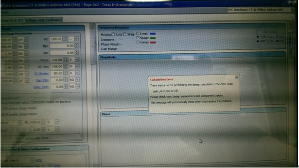

In UCD3138 PFC’s project, I use the topology of Interleave with shunt method. But there is an error message as following figure while I invoke the Fusion Studio Online. The error message is shown with “Gain_set_loop is Null”. Because there is no CT in my shunt method.
According the user’s guide of UCD3138, I know there is no topology of Interleave with shunt in UCD3138 PFC’s project. But I can invoke the topology of Interleave with shunt in Fusion Studio Offline mode.
Figure 1. the error message while I invoke the Fusion Studio Online.

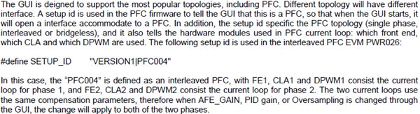

But, I find the p.23 in application note of SLU712 as following figure 2. The user seems can design the mix-topology by defining the SETUP_ID with PFCXXX.
Figure 2. p.23 in application note of SLU712.
