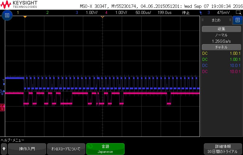

    I  connected PMIC's SCL and SDA to exernal power supply(ePS) via 3kohm.
    After PMIC power-on and ePS set to 3.3V, SCL and SDA droped to 0.9V.
    When ePS raised to 5V, SCL & SDA remained 0.9V.
    (I suppose PMIC I2C lines are protected by Zennner Diode to prevent Over Voltage malfunction.
     Maybe PMIC start up properly, then Zennner Diode is cut off from I2C lines....)
    (CH3 = SCL, CH4 = SDA)
    When I sent "Read Command" under the situation(from converter to PMIC), I2C swang 0.9V-0V.
    But the voltage was too low to recognize the serial packet for converter and PMIC.
     Probably, my PMIC sequence can't reach the I2C available step.
     If there are any checking contents for me, let me know anything.
    Best Reagards.

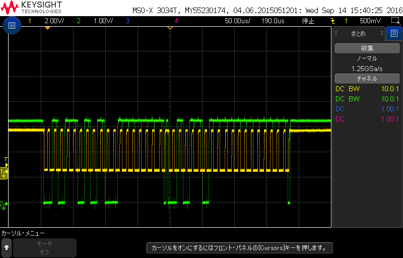

    I improved the low-voltage problem (rose from 0.9V to 3.3V as attached below).
    The reason was that I didn't supply PMIC's VDDIO, so I supplied 3.3V to VDDIO.
    (Of course R69 and R72 were removed.)

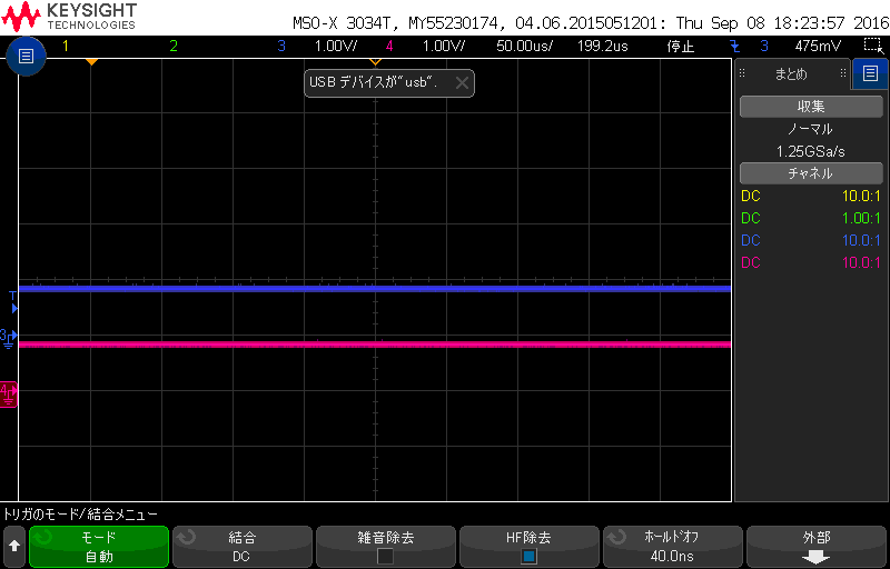

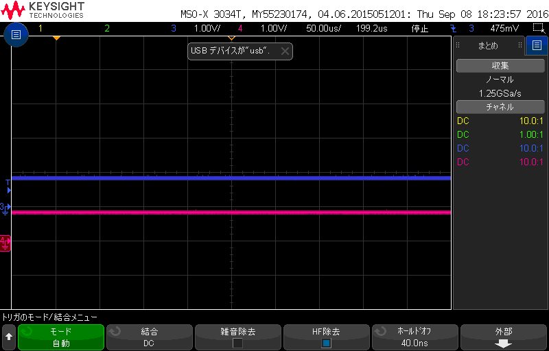

    But, PMIC returned no ACK via I2C.
    According to SLVA704, my command from Master port seems to be correct.
    (When I didn't supply any power to PMIC and Master sent same command to PMIC, I2C waveform was same as power supplied.)
    slva704.pdf
    PMIC power was supplied.
    I2C_READ.pdf
    PMIC power not supplied.
  • Did VREF recover to 0.8V? If not, the PMIC is probably still OFF and would not have i2c capability.
