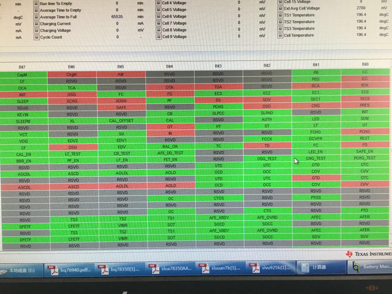

    Per your suggestion, we are trying to configure BQ76940 through BQ78350 using "Battery Management Studio". But we have encounter another question:
    I used the Cell simulator on BQ76940 to act as 15 series battery. And I applied a 36V DC voltage to the BAT+ and BAT-.  That is 2.4V per CELL.
    When Power on, the register map of BQ78350 shown as below, we got a CUV fault.

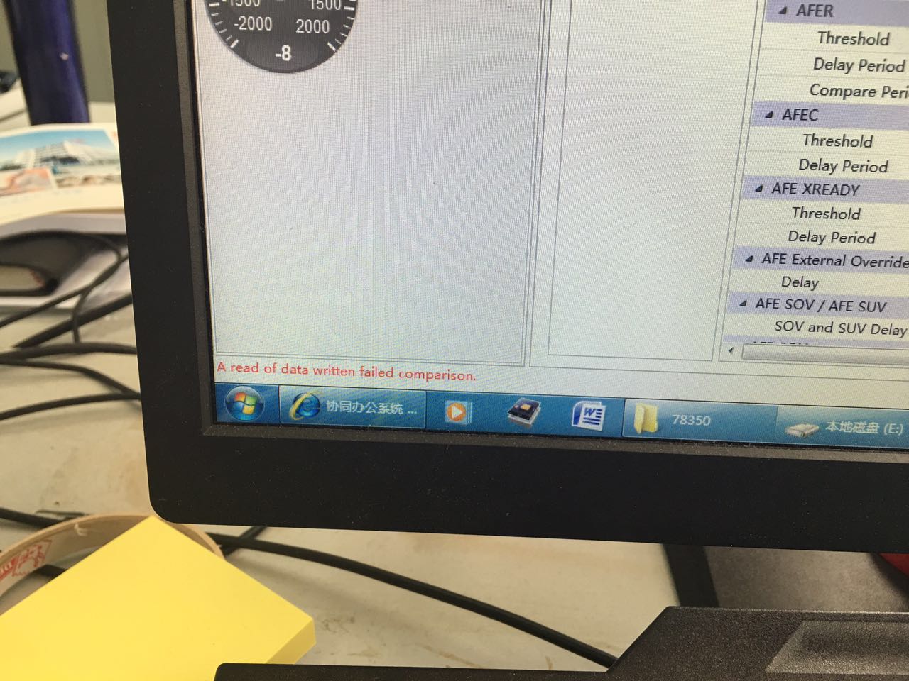

     I recognized that the under voltage threshold of BQ78350 has a default value: 2.5V. But when I tried to modify this under voltage threshold, it reminds:"A read of data written failed comparison" ,shown in the left lower corner of below picture:
    It seems that i can not configure the BQ76940 through BQ78350 as long as this CUV fault exist ? Any way that I can clear the fault and modify the Under voltage threshold? Thanks !
