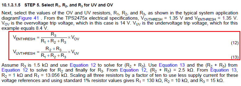

Hi Team,
It seems the following equation 12 and 13 are typo.
I believe the following equations are correct.
V_OVTHRESH = { R3 / (R1 + R2 + R3) } x V_OV
V_ENTHRESH = { (R2 + R3) / (R1 + R2 + R3) } x V_UV
Is my understanding correct?
