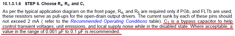

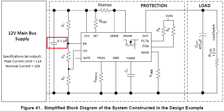

Hi Team,
I couldn't find C1 capacitor that is described below.
Is C1 the following red part?
I believe it but would like to confirm just in case.
