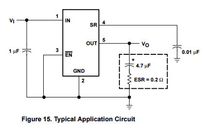

Please tell us about the treatment of unused pins.
EN-pin(3): Floating OK? or Connect to GND?
SR-pin(4): Floating OK? or Connect to GND via a capacitor?

Hi Kato,
If /EN is not used, it should be connected to GND.
SR is meant as a way to filter the internal reference and provide a controlled startup by charging the external capacitor desired. As such it is designed to be either floated or connected to GND through a capacitor. We recommend a 0.01uF capacitor for best noise performance.
