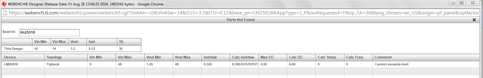

Lines 2 and 3 have to be powered by LDOs as they need to be not much noisy. By scaling them with voltage and with a supposed 80% efficiency, what I need is a 6-7 V, 130 mA line which has to be connected to the first 3.3 line and with an isolation barrier in the middle. Obviously, this means that the 3.3 line current output raises to about 250 mA.
I tried to give a look at Webench, but it only gives me fly-buck options with LM5160 and LM5161 with huge transformers. Looking around, I found LM25018 to be more suitable for my application, but don't understand why Webench did not suggest it. Moreover, when I try to start a design in Webench directly from its page I always have an error "The server is temporary unavailable". Hence the question: did I miss something? Is there a practical reason which suggests me not to use it?

  • Hello Stefano,
    Regret the late reply. Sorry for the confusion. Now I see what the issue might me with the LM25018 WEBENCH design.
    If you are planning to use say 6.6V(@130mA) for the isolated secondary output and the primary voltage at 3.3V (@ 120mA) you will need a Tx with effective turns ratio as 1:2 (Npri:Nsec). In that case your effective net primary current will be (120mA+ 2 x 130mA). Then your net primary current will close to 380mA. While calculating the primary inductance of the Tx, one needs to calculate the Lpri ripple current which is generally set at 30% of the net primary current.
    If 380mA is your net DC primary current and you have a ripple of say even 30%, your peak Lpri current will more than 390mA (the minimum peak current limit of the part) and the IC will exceed the HS FET current limit. At least that is the case for the LM25018.
    However, that being said, the L25017 should have shown in the Webench. I will need to follow up with Webench team for this issue.
    I suggest you use the LM25017 for this design followed by the LDO for the secondary outputs. I will not be the correct apps person to advice about the TPS part as I do not support that part. However, I think it should be doable, but you will lose the scope to change your secondary output range, if the need arises.

  • Hello Stefano,
    I repeated the same range again in the Webench and I got the same issue again (exceeds current limit). See attached.
    I used 10-14 as VIN, 3.3V@120mA as VOUT1 and 6.6V@130mA as VOUT2. Checked the isolated output option. Of course it just shows up the LM5160 and the LM5161 as results but if click on 'show why other parts were not found' you should be able to filter out the LM25018 and see the reason.
    That said, a Fly-Buck approach will be very space-conscious and will need only one Tx, a diode and the preload resistors. There is no need for any snubber circuit and with less stress on the SW node.
    I have attached here a custom schematic (with 1:1.5 Tx) where we had created a design for one customer using the LM25018. You can see the component count here and you should be able to keep the board size to 15mm x15 mm (or lesser: see PMP15006). You should be able to secure an efficiency of more than 82% with this design.
