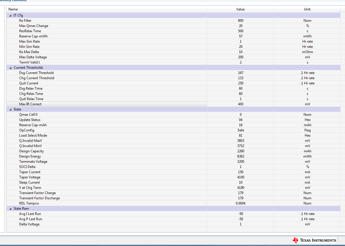

I'm trying to run a learning cycle by a bq27425-g2a on a 2200mAh Io-Li battery.
I started with the RESET and the BAT_INSERT commands, after I discharged the battery to 3V with a 450mA, waited until VOK and RUP_DIS were cleared and OCVTAKEN set  so I suppose the first valid OCV has been taken.

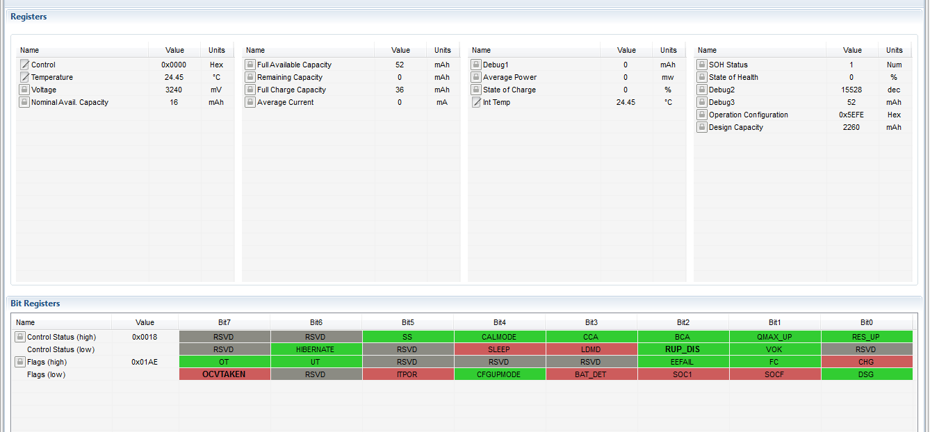

Control Status: 0x0018
Flags: 0x01AE
 But when I start the charge the battery goes out from the SLEEP state and BAT_DET is cleared. I can't continue the learning cycle with BAT_DET cleared, as the battery is not anymore detected. Where am I wrong?
