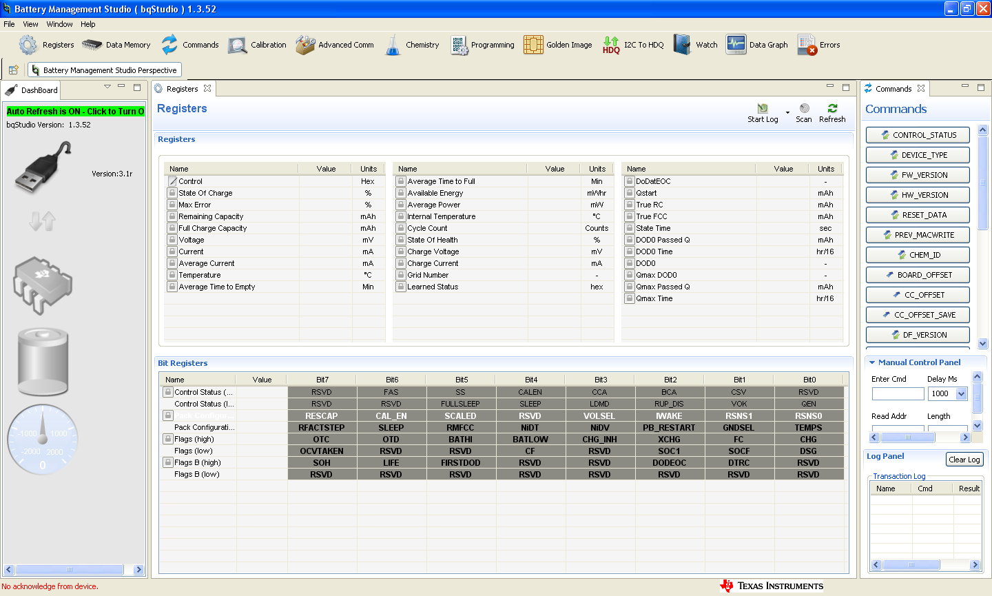

 I wanted to run a learning cycle for bq34z100 gas gauge for a battery pack. I changed some of the Data Memory parameters and after re-programming using the golden image, there was no communication with bq34z100 and reconnecting the BAT+ and BAT- also didn't make the communication. Can anyone help me understand the problem? How can I make the communication?

    Thanks for your reply. Yes, I am using bq34z100 EVM with bqStudio. I attached the communication error.

  • Hi.. I'm not a T.I. employee but I thought I'd contribute some of my own info for what its worth...
    I have had a similar problem when the programming of the golden image was interrupted or aborted before the device was fully programmed.
    The solution for me was to boot the software (manually) then ignore the initial screens and go directly to the programming screen.
    Then just reprogram the chip from there... exit the BQ studio... then reboot BQ studio.
    Also, my device's firmware uses the I2C interface to talk to the T.I. Chip. If I attach the BQ EVM to the I2C bus , it can interfere with the communications. In order to keep the embedded firmware from interfering with the BQ studio EVM I have to put the embedded device asleep, or in a special state (no I2C com) until the BQ studio is removed.
