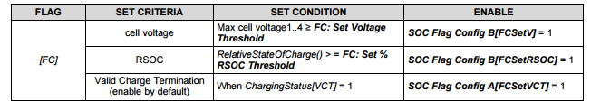

I have been working on getting the BQ40Z60EVM to correctly gauge my 2S LiPo battery (250 mAh) for an entire week straight, but no progress. Most likely because I somehow cannot complete a full learning cycle. This due to not being able to charge to full charge giving [FC] = 1. At the bottom I've added a gg.csv file. Could someone please give me some guidance, or provide a modified gg.csv file I could work with?

    Thanks so much for all the answers. First of all I'm using a very standard LiPo battery with also a standard ChemID. (0100 if I'm correct.)
    I'm still unable to charge the battery to more than 8100 mV while the charging voltage is set to 8400 mV. Would you happen to have a gg.csv file for a two-cell LiPo that you could send me?

  • Hello Floris,
    I reviewed your GG file. It looks like your EoC for the cells get to 4172mV and 4189mV, respectively; but the charge termination [TC] and full charge [FC] voltage thresholds are set to 4200mV. If the cells voltages aren't greater than or equal to the threshold voltages set, [FC] flag won't get set. You will have to increase the AC adapter voltage or reduce the thresholds to 4150mV. Also you need to make sure RSOC >/= TC set % RSOC Threshold. These settings are located Data Memory>>Gas Gauging.
    Page 64 of the TRM list the three conditions that must be met for [FC] to get set.
    Also I noticed that the Qmax Cell 1 and 2 are 125mAh, but Qmax Pack is 250mAh. What is your cell configuration? 2S2P? If it's 2S1P as previously mentioned then the pack capacity should be the same as the cell capacity, since the cells are not in parallel. Pack capacity is cell capacity x ?P and Pack voltage is cell voltage x ?S. I recommend you update the Qmax cell or pack to match and design capacity in mAh and cWh.
