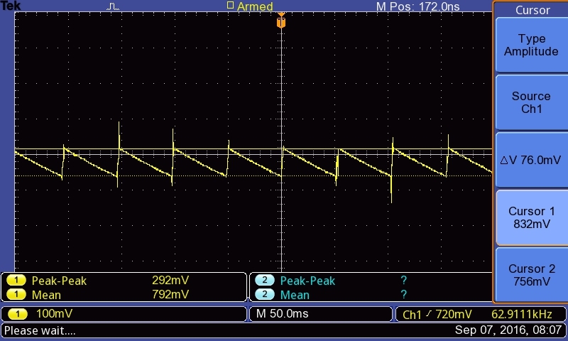

    Attached are images of the waves at PH (blue wave) and VOUT (yellow wave).
  •  After replacing the chip with a new TPS54531 with servo, the damage " shorts out internally between the pins VIN and PH" can be repeated, right? With servo, how about the inductor, very hot or not becaues have some concern the power on inrush current of servo should be very large, any possbile touch the current limit or inductor saturation to make it short or you can check the inductor current?
