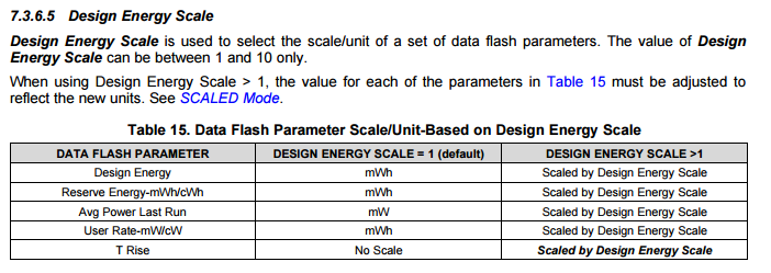

  • Hi Kingston,
    The maximum Design Energy that can be entered is 32767mWh. Use the Design Scale and enter 28800cWh for Design Energy. Also Cell charge voltage Tx-Ty should be entered as 2400mV.

  • Hi Damian,
    You said that use the Design Scale and enter 28800cWh for Design Energy.
    My design energy is 288000mWh , so is the design scale  288000/28800=10? or 288000/32767=8.78?
    Respectfully yours,
    Kinston Shih
  • Hi Kingston,
    I would recommend using design scale 10, so you have some headroom. You can use 8.78, but there's no headroom. Also be sure to update the following parameters in table 15 accordingly.
  • Hi Damian,
    So is it mean that I should update all the following parameters since the design energy scale >1?
    And can I know the value that I should type in the following parameters?
    Respectfully yours,
    Kinston Shih
  • Hello Kinston,
    These are all specific to your application, so I can't tell you what you should put for these parameters. These parameters defaults are 0, so you shouldn't have to do anything unless you change the defaults. If you change the defaults, just make sure the values you entered are scaled by design energy scale value.
