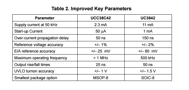

  • Hi Mark,
    Here are my suggestions.
    1)  and 2)Please refer to slua257 for the comparisons between UCCX8C4X and UCX84X, and the differences of parts of UCCX8C4X families
    www.ti.com/.../slua257.pdf
    UCCX8C4X is pin to pin compatible with UCX84X. Below are a comparison table
    To realize the soft start, both UC3843 and UCC38C43 need external circuits.
    In section 4.7 of Slua257, there is the example circuits for soft start.
    I think you could replace UC3843 with UCC38C43 and add soft start circuits.
    3) Yes, you can.
    4) Yes, you can.
