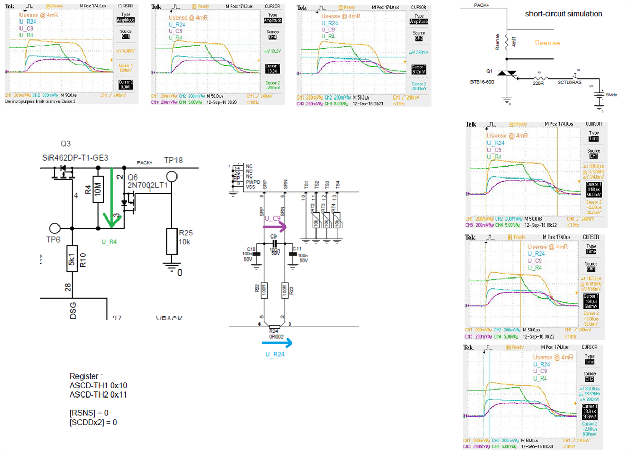

Let me review your post and get back to you. Can you provide more details on how you're creating the discharge short circuit event? Your register ASCD1 and 2 settings are for 33A and lower with delays of 305us and lower based on the info you provided above.

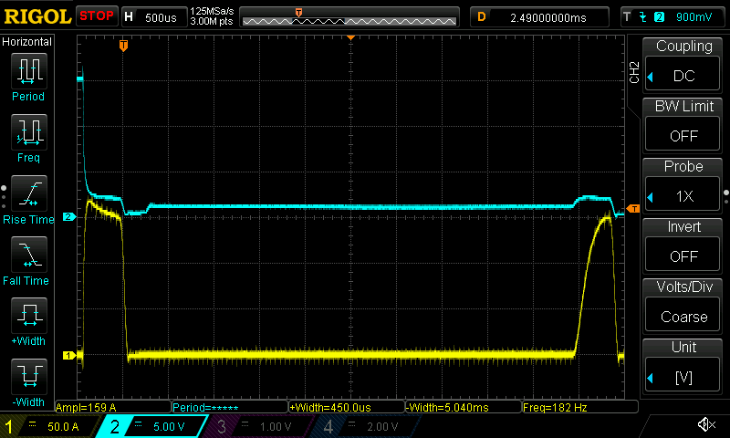

Can you also capture the same plot, but include the voltage on CHG/DSG pin? We would like to see when the gauge send the signal to turn-off the FET as well.
Hello Telix,

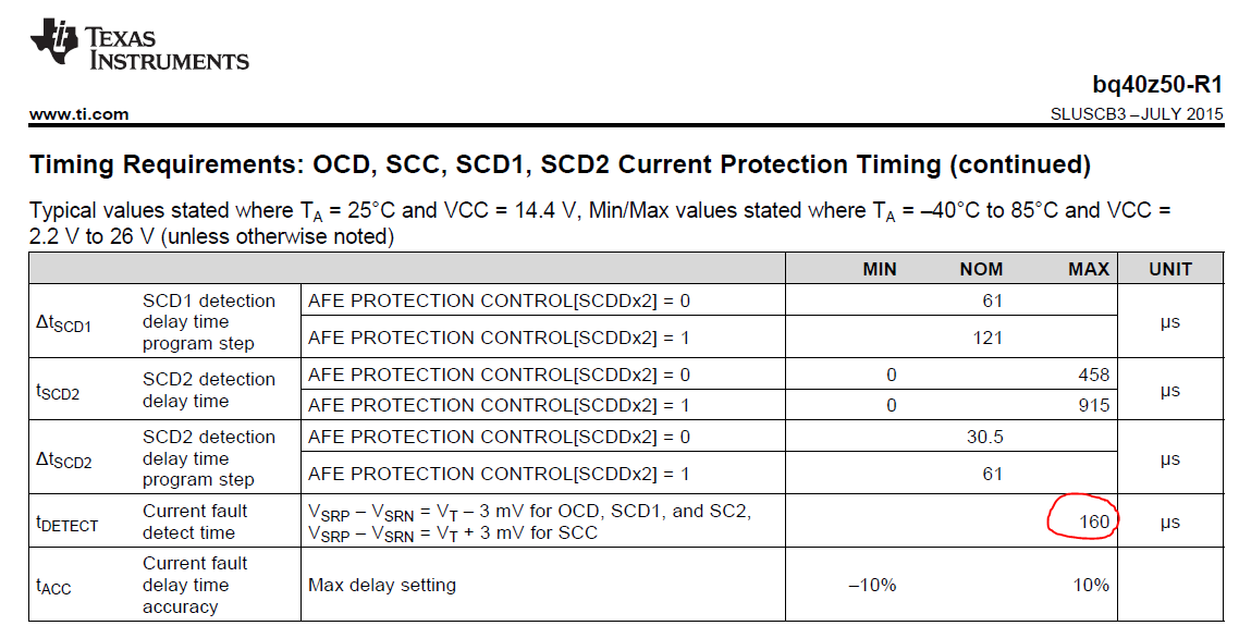

Thanks for the scope captures based on the green trace of the DSG voltage as expected the gauge sent the turn-off signal, but the FET takes longer to turn-off due to parasitic capacitance. When measuring the ASCD1 and 2 delay looking at the green trace, you need to take into consideration the 160us max current fault detect time that's on page 17 of the datasheet. The measured delay at DSG pin (green trace) is ASCD1/2 delay plus current fault detect time.

I did not take into consideration the "tDetect" parameter.
I thought that after exceeding the timer timeout , the chip logic commands the discharge FET immediately, having regard to Cgs.
