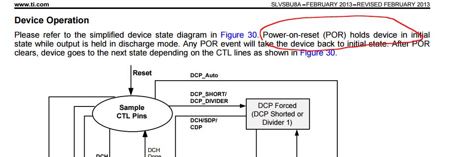

Does anyone have TPS2544 POR time?
During rising VIN, there is a short internal delay of 1-2us after VIN goes above VUVLO (4.1V) to be ready but this is small compared to the OUT Tr, Tf, Ton, or Toff.
