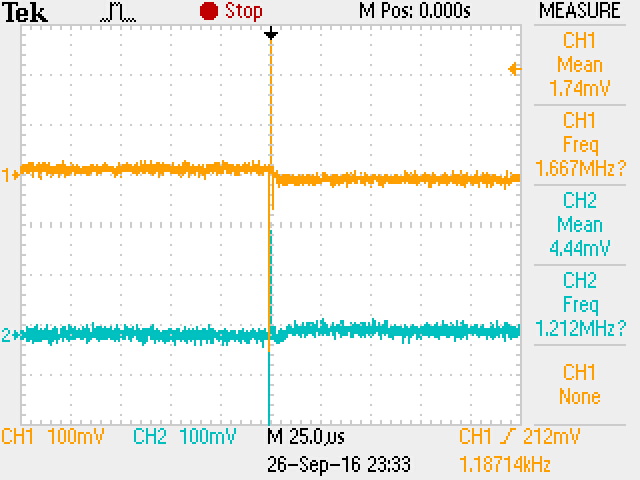

we have chosen the TPS65131, with or without load the voltages are proper. but there is more noise in the power supply output. when the output is observed in CRO the glitches are present. Please let me know how to resolve this issue

    -Ya the voltages are measurable, -3V and +4volts, but the ripple is more. since the application is display device, this noise will add up in display image of the display.
    I have tried with 10k, 20k, with nearest about the 100k. there was no change in the wave forms. I tried to replace feed back loop passive components, but still the problem is was not resolved. Please find the attached wave forms. please suggest me to get out of this issue.

    The resistors you added to C4 and C27 will not change the glitches you observed on your scope on the output voltages. What you name glitch seem to be the switching noise of the converter and normally the energy content of these glitches is not high enough to cause issues on your display. Especially measuring the real noise on the output is really hard because especially the glitches you show on your scope plot are most probable a lot higher than they are in the system because they are heavily dependent on the measurement setup. Please refer to this blog for more details on this: How you measure your ripple can make you or break you
    I expect that there is something else causing the problems that you observe on your screen. Please try out if the problem with the display is reduced or removed when setting the PSP and PSN pins to GND. PSx allows the converter to stop switching if the output voltage is high enough. The advantage is increased efficiency, the disadvantage is increase output voltage ripple.

  • hi,
    sorry that is not coupling, its decoupling capacitor at output side, since as given in datasheet C3 and C4 are output capacitors parallel to the output capacitors I have put 100nf and 10nf for testing purpose. here is the wave forms for output ripple without load. frequency is 530hz.
    My issue is with the voltage ripple. I want to reduce these ripple voltage. If I reduce this ripple voltage my issue will be solved.
  • Hello Vinaykumar,
    The pins PSP and PSN allow or prevent the IC from going into the power save mode. The ripple looks as if you have low output current and the output is in power save mode. I expect that the ripple is measured on the positive output voltage, so please check if PSP is connected to VIN. If this is the case, please test if your problem is gone when connecting PSP to GND.

  • hi,
    what is 530hz noise, I couldn't get it, my issue was solved by replacing the DIODES, replacing the capacitor and adding capacitor, there was no effect, but the diode change has lot of effects, the noise minimized to some extend.
