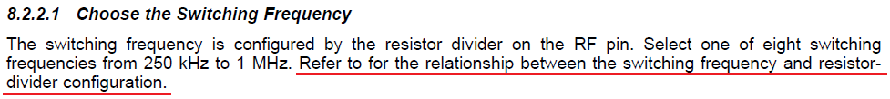

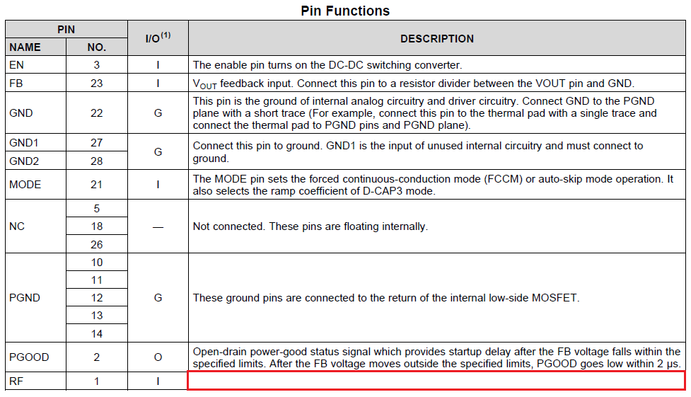

Hi Team,
There is no discription for RF pin in datasheet.
Could you describe it on next datasheet update?

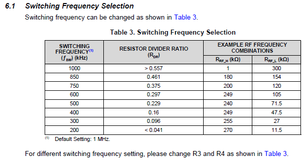

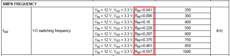

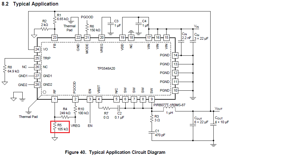

In addition, it seems there is relationship between the switching frequency and resistor divider in datasheet.
Which page should I see?
