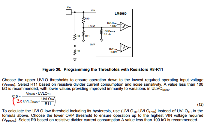

Our customer use 3pcs of LM5060-Q1 for battery front end in Automotive.
The OVP and UVLO setting values are same on three devices.
Currently we use difference resistors for setting the OVP and UVLO.
Can we use same resistor for OVP, UVLO setting on three devices ?
They would like to reduce BOM.
Does it affect the detection accuracy of the device?
I can send the schematics on the e-mail. (asaka-r@clv.macnica.co.jp)
