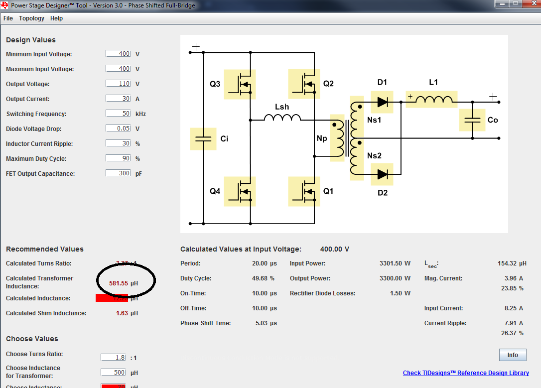

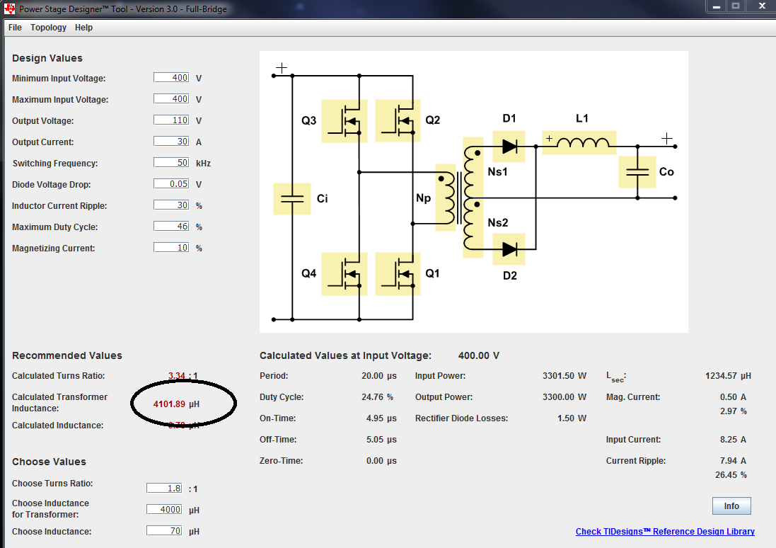

Two years ago I developed a 3kW DC/DC phase shift Full Bridge, starting from Power Stage Designer 2.1 tool.
In Power Stage Designer 2.1 was present only FB simulator and not the Phase Shift.
Now in Power Stage Designer 3 there is Phase Shift Full Bridge. So I have tried to simulate the same and I have noticed a BIG difference in CALCULATED TRANSFORMER INDUCTANCE.
Can somebody explain me please?
Why there is this big difference? There are different formulas?
To reference I used tis formula to calculate Lprimary --> Lm=(N2*Vout2) / (32*Coss*Vout2*Fsw2)
Below the Power Stage example
