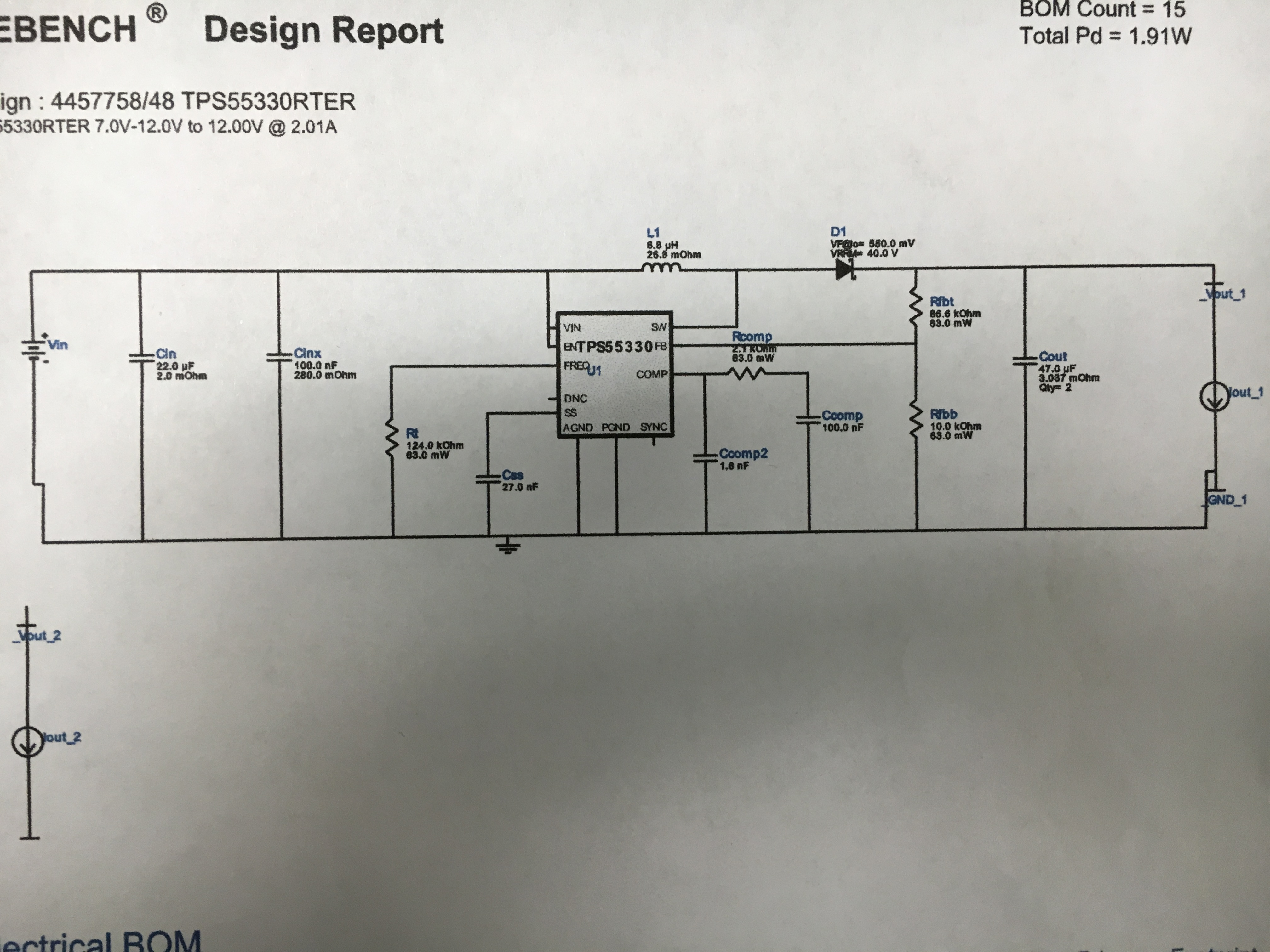

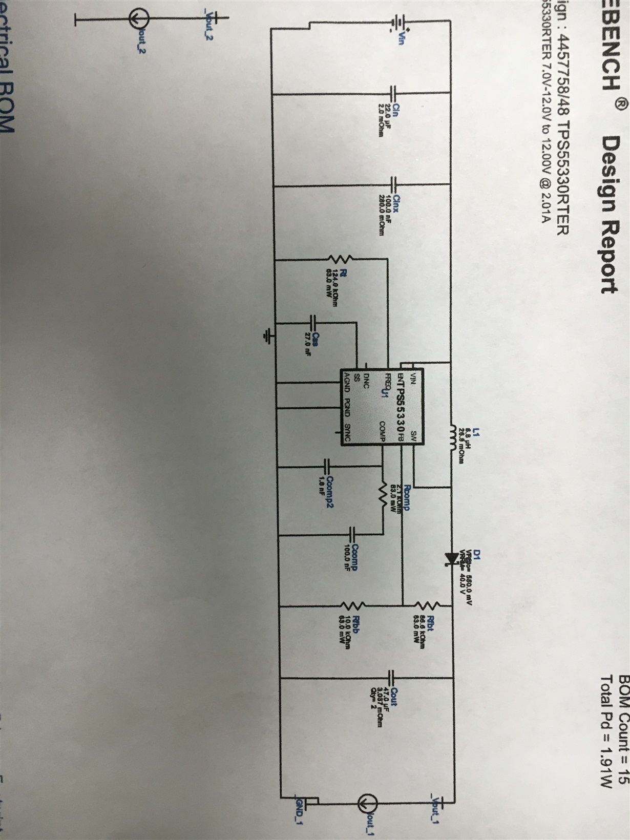

TPS55330
Issue with V out. I am using the chip for Vin ( 7V - 12V) and output 12V at 2.01A.
I am using Electrolytic Capacitors instead of ceramic and there inductor which I am using is far off in terms of resistance. The schematic requires inductor with 28.8 milli ohms and I am using a similar inductor (6.8 micro Henry) but with much higher capacitance.
The issue is that if I drop the input voltage from 12V to maybe around 8 or 9 and turn it back up, the setup stops working. At that point it starts to follow the input and does not maintain a steady 12 V output. The same thing happens when I try to start at 7V input, increase it to say about 10V and turn it back down, the output does not remain steady.
The only way to make it start working again is to power everything down and turn it on after a 10-20 seconds.
