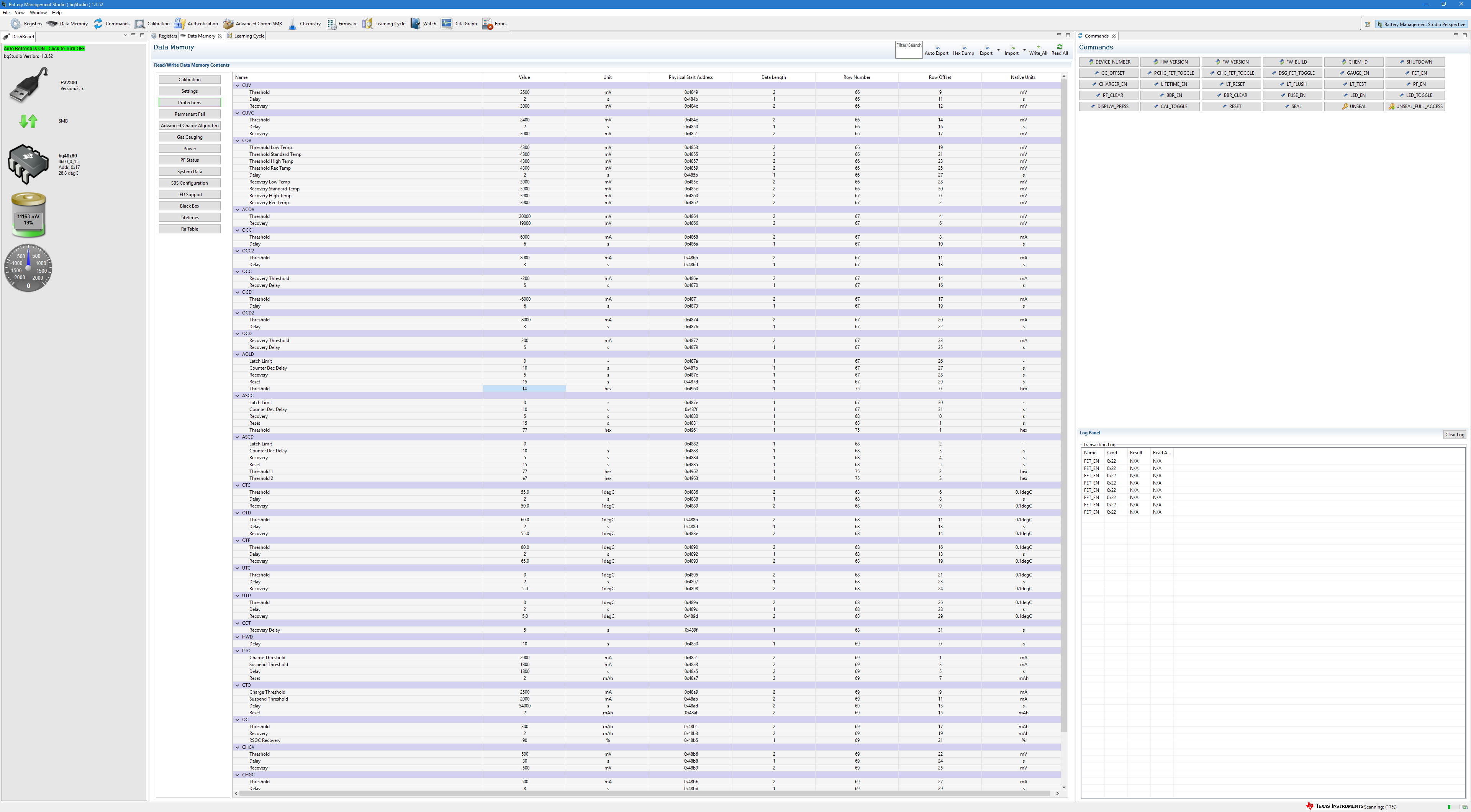

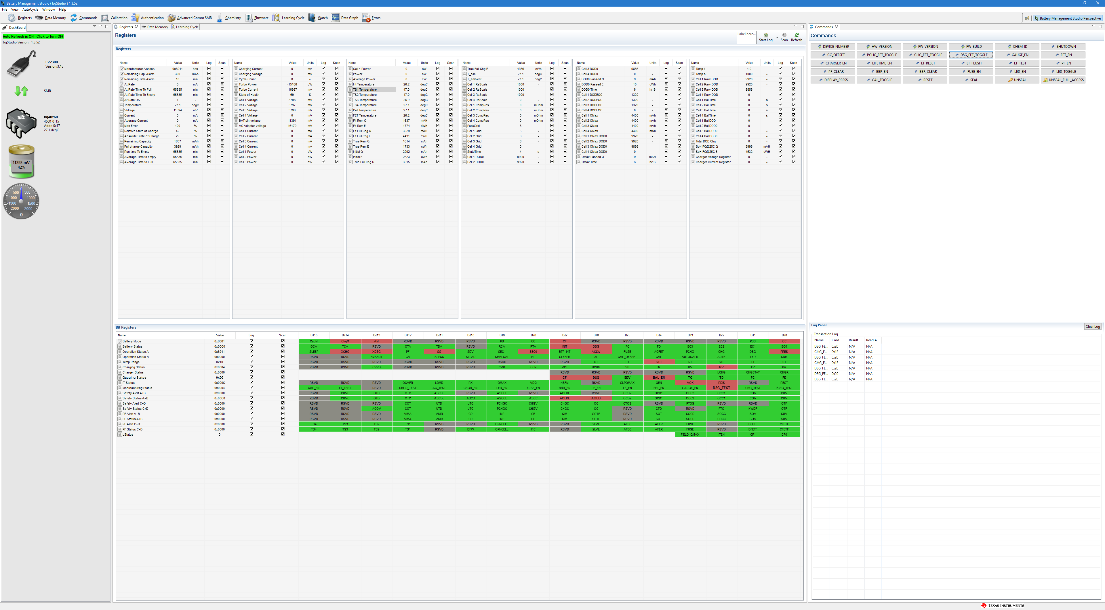

I managed to start the first stage of the learning cycle, actually discharging the battery. Then I noticed the current reported by my load was very different than the current reported by bStudio. More on this in a different post.
Now, the DSG output is not turning on. I think this is because AOLD is getting tripped but I cannot figure out why.
The only thing that is slightly wrong are the reported temperature values. They should all be around 27C as the board is idle but two of the temperature sensors are reporting as ~47C. I get an error when trying to calibrate these values: out of calibration range. But disabling the two sensors that are obviously wrong doesn't change much.
Did I somehow damage this bq40z60 again? Anything I should check?

  • I was trying to run the learning cycle again today. It started just fine. I noticed some discrepancies in current readings so I disconnected my load. Then XDSG got tripped again and now DSG output will not turn on.
    Looking at the TRM, I see that XDSG can be set/triggered by many different conditions. The first condition that says it trips the XDSG is if FET_EN is 0. However, when the learning mode started, FET_EN was 0 and XDSG was not tripped. This seems like an inconsistency between the datasheet and the bq40z60.
    I also had the logging turned on while this all happened.learning.log
  • I've turned off the AOLD and AOLDL protections temporarily to see if that is what was causing the problem. XDSG no longer turns on so I think that confirms that I'm tripping the AOLD. However, I don't understand how.
    Looking at the TRM, I see a values from 0 through 0xf  should be used as thresholds which correspond to certain voltages which in turn correspond to discharge currents. In my "protections" settings, I see that the default value for "Threshold" for AOLD is set to 0xf4, much higher than the seemingly allowed range. Is this causing my problems? While I'm here, I'm not seeing where "Overload in Discharge Protection Delay" is set.
    After disabling the AOLD and AOLDL protections, I tried to start the learning cycle. The outputs turn on for a quarter of a second, if that. I can hear a barely audible "click" and also see a small, short voltage appear on my load. It looks like it is shutting itself down for protection but I'm not seeing any indication of the failure in the register view.
    This seems like it might have changed when I ran the calibration routine that I've talked about in another post. Is it probable that I broke or misconfigured something there?
  • Cameron
    The hardware based protections, AOLD, ASCC and ASCD, cannot be disabled. The protection setting just disables their reporting in the register. I would set them to their maximum values and see whether the limit still trips. You will have to power-up reset the device after changing the parameters and you can do this by removing and applying the cells. How much current are you trying to support and what value sense resistor are you using?
    Tom
  • Ah, OK. I wish that it was more clear in the datasheet that you could not actually turn them off.
    I've got my load set to a constant 20W. By battery is at ~11.1V, so a little under 2A.
    I have a 3mohm sense resistor on the pack and a 10mohm sense resistor on the AC input.
    Should I set the "AOLD" "Threshold" to 0x0f or 0xff for maximum? Is that the correct register to set? The datasheet seems to indicate 0x0f however the default value is above that. Is it possible the upper nibble is masked or not used internally?
  • Instead of messing around with those thresholds, I tried a different load. It looks like my load box was not purely resistive and the startup currents were too high. I hooked up a fixed 6Ohm 50W resistor instead and the discharge cycle started as expected. (Automatically, with FET_EN set to 1, which didn't seem to be working before).
    For those that need it, the "Termination Voltage" that is used by the learning cycle is a pack level voltage. This was not clear to me. (Why is this even an option? Wouldn't it be better to set this as a cell level value? Anyway...)
    Then I ran into some trouble as one of my cells was ~.4V below the others and was triggering a CUV protection. I could not figure out how to enable balancing or there was no evidence that any cell was being balanced. I fixed that by just externally charging that cell directly back to a similar voltage as the other cells.
    Now the learning cycle has finally finished discharging. I don't trust the hardware enough to leave it alone for the actual charge cycle so I'm going to re-start it tomorrow morning. I'll see if I can't figure out how to cut down the relax time since the cells will have been relaxing overnight.
    I'm still a little worried about the balancing seemingly not working...
