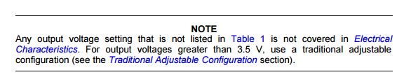

I have a design using the TPS7A7300 configured per the datasheet notes, using all the ANY-OUT pins to set it at 3.65V output, and using a 5V input.   I have a large amount (over 2000 uF) of low ESR input capacitance, and 200uF of low ESR output capacitance.  The output is connected to a module that normally requires around 700ma average, but does have peak transient loads (of 1-2 ms) that can reach 2A.  The setup is basically working, but when the load (the module) goes into the mode that requires the 2A current pulses, the regulator seems to limit the current output (at around 800ma) and the voltage drops from 3.65 to around 2V for a brief 2ms spike.  But the regulator is supposed to support up to 3A or more.  Is there something that could be causing the current limiter to trigger prematurely?  If I add 2000 uF to the output, the impulse load required by the module is provided by the caps and there is no issue.  So it seems the TI is not providing the fast load transient response that I expect.  Any suggestions?
