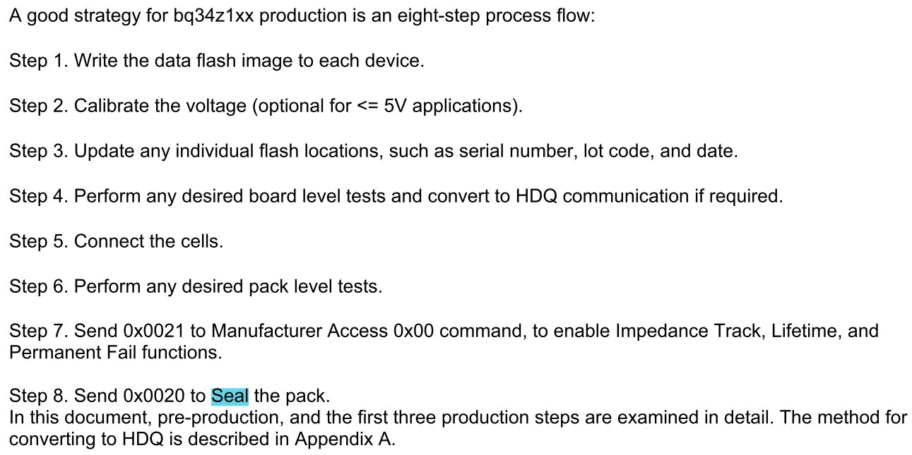

bq34z100-G1 / SLUA665, Need unseal before writing the data flash (Step 1) ?
Other Parts Discussed in Thread: BQSTUDIO, BQ34Z100-G1
Sorry for simple question.
Now I'm referring the production flow for bq34z100-G1 in SLUA665, and then I'd like to know if the unseal is necessary or not before writing the data flash. I'm asking this because the unseal command is need to send when writing the data flash at bqStudio.
