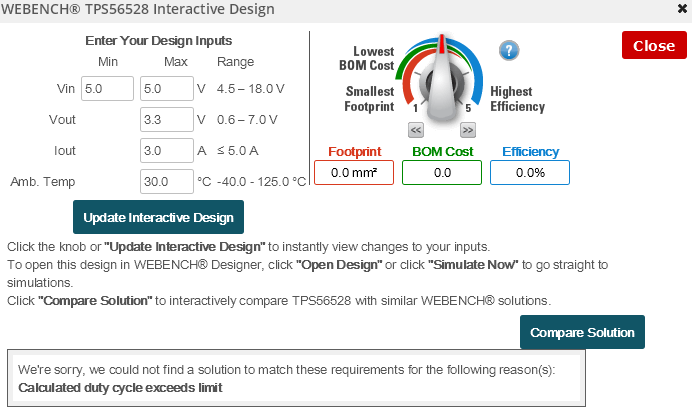

Hi Team,
when I try to simulate TPS56528 in Webench with 5V -> 3.3V @3A it tells me "Calculated duty cycle exceeds limit". In the TPS56528 datasheet I could not find any duty cycle limitations. Is this a bug in webench or am I missing something?

  • Hi Nick,
    thanks for your help! I can simulate 5V -> 1V for example so I think it should be possible with Webench for 5V input. This is what I get with 3.3V:
    If this is a bug can we please escalate to Webench team?
    Simon

  • I can tell you a little about the history with this.
    TPS56528 uses DCAP2 control. It does not have an oscillator to set frequency. There is a minimum off time that limits the maximum duty cycle. For TPS56528 it is nominally limited to 78.55%. As the input voltage is decreased towards the output voltage, the duty cycle increases towards this maximum hard limit. However in actuality it is a soft corner. As the duty cycle approaches this limit, the output regulation degrades slightly. So Webench has a hard limit, which I think is set to 65% to have some margin. For Vin = 5 V and Vout = 3.3 V. the nominal duty cycle is 66%. However losses in the IC will tend to increase the duty cycle so the Webench calculated duty cycle will exceed its limit. You can defeat this by raising the minimum input voltage slightly in Webench.
