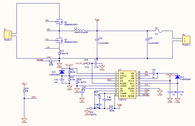

Hi guys.I meet with some questions and look forward to your replying.Pls kindly find more details below.

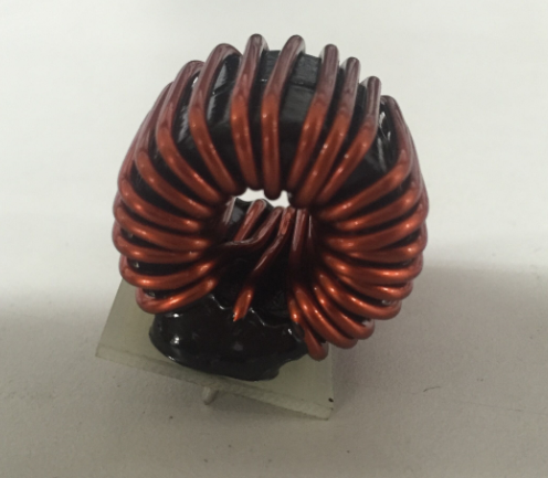

Here is my schematic and  shaping of  the inductance
input 31.5V . I  need 11V output

Output waveform is triangular wave.Output meets disign requirement.But I  do not know why I cannot test the drive voltoge of MOSFETS?
Light load
When I add a 50ohm resistor to the  output.Lm5116 chip damage  in a short time.I don't understand what caused it?

  • I'm not an expert on LM5116, but I am not seeing any input capacitance across the high and low side switches. There is also very little output filter capacitance. You might start there.
  • I will contact an engineer more familiar with the part, but in the mean time, can you provide some more information.
    What load currents are you trying to achieve? When you say you add a 50ohm resistor to the output, are you saying 50ohm to ground on Vout? How long is "short time"? 1 second, 1 minute, 10 minutes?
  • John is right, there needs to be more input and output capacitance.
    Can you provide any waveforms for "normal" operation and after the IC is damaged? Is the LM5116 still switching? What is the VCC voltage? Observations like this will help to narrow down the cause of the problem.
