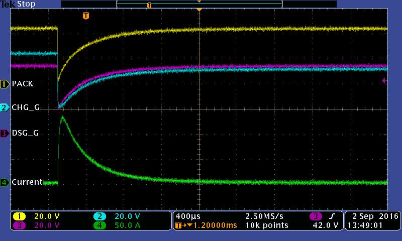

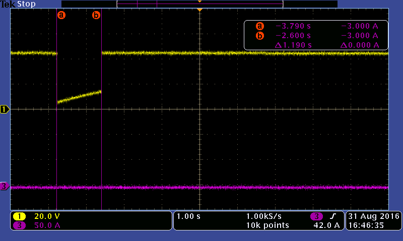

We design a battery pack (12S2P) to use bq78350+bq76940+bq76200 to implement it but we fouund a problem was as below
We found there’s an issue of the inrush current testing, please see the normal and abnormal waves as attached.
The test conditions are loaded by 470uF and 1,000uF capacitor, the voltage has dropped drastically with 100us and it has been went back to normal wave around 1s, we tested 10 times but 3 times happened, 30% probability. Can you advise the reason why it is and how to improve it. Thank you.
  • Most likely your are encountering a SCD event at connection of the capacitors, and with some charge still present turn on is successful at 1s.  Since it works 70%, the performance may be close to the threshold and you may see results change with system.  Some solutions below may be possible, be sure to consider the effect on real system SCD conditions as well as capacitive.
    - Increase the gauge ASCD threshold or delay so the SCD does not occur with the capacitance.  The system must be able to take the higher current in other operation.
    - Decrease the ASCD recovery time in the gauge so although it will still have a SCD, it will try to recover more quickly and pump up the output voltage on the load capacitance. The FET must be able to take the current if it is connected to a real short circuit. Use ASCDL settings to allow the FET to cool before trying the sequence again.
    - Increase the gate resistor to the discharge FET to slow turn on.  This won't help the initial SCD occurance but may avoid the possibility of a SCD on the re-try.  A slightly slower edge may reduce the current peak or duration above the threshold. Increasing the gate resistor will also slow down turn off, and too much increase will slow the switching so that CVDDCP on the bq76200 is depleted and turn on will not be successful.
    - Implement a pre-discharge circuit as shown in the apnote for the bq76200.  This is another solution which does not prevent the SCD event but may help with recovery into the capacitance. The bq78350 does not have a feature to control such a circuit, it would need to be controlled on a command from the system.
    - Build in a current limiter.  This is typically undesired due to the complexity and it would function before the system SCD.  In the event of a real SCD the current would continue at the limiter voltage until another overcurrent threshold was reached.
