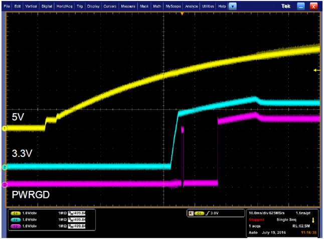

When the TPS54310's power supply voltage will start too slowly, it will be this waveform.
For this waveform.
when this device starts to output, this device's PGOOD Circuit has not yet been successfully behavior,
so it can't drive to "Low Level".
Is this recognition correct ?
