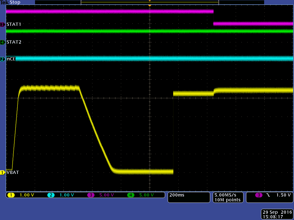

I am facing an issue that bq24105 will not go back to detection mode when the battery is removed at voltage between 3.7V and 4V.  However, when battery voltage is at 3.3V or when the battery is fully charged, the charger will go back to the battery detection mode.

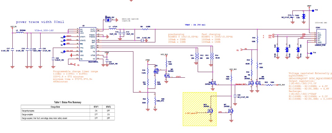

Since some batteries are without a NTC, I have a NTC on board for those batteries, and I have simplified the application by removing extra circuit but the issue still remains.  Is there anything inappropriate in the design?

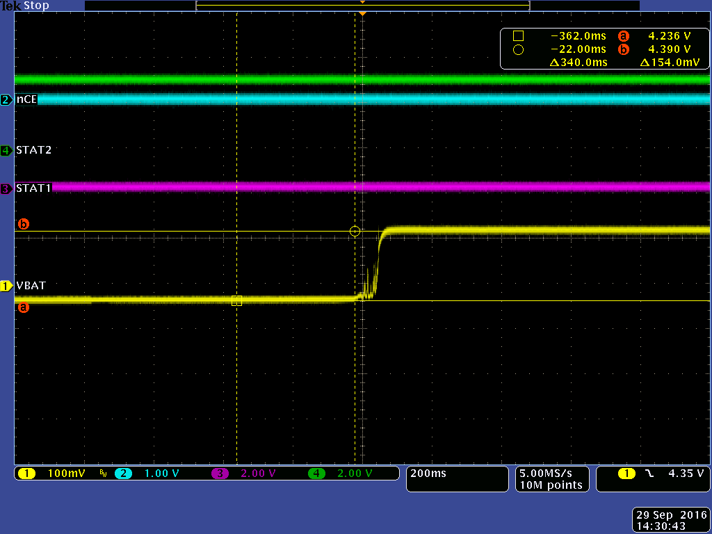

  • Can you share scope capture on the insertion and removal of the battery? Please probe the battery voltage as close to the BAT pin as possible.
    The functionality of the device is the same except the bq24125 has enhanced EMI performance.
  • Hi Jing,
    Here is the waveform when inserting/removing the battery.   Please let me know if there is anything I need to change in the circuit.  Thank you
    Battery Insertion:
    Battery removal:

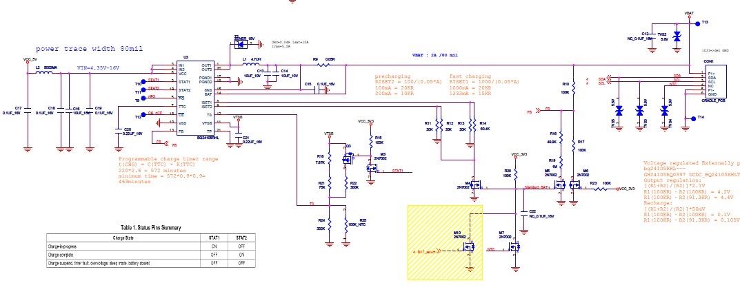

  • Can you please upload your schematic with higher resolution? The one you uploaded in your previous post is not clear.
    When the battery is removed, the output signal goes up due to the stored energy in the inductor.Looks like for some reason the voltage at BAT is held at 4.4V. Can you also plot the output current? IDISCHARGE applies after the output current goes to 0.

    I have solved the issue. It turned out that MOSFET we used to control the current for batteries without a NTC was the cause when it was off.
