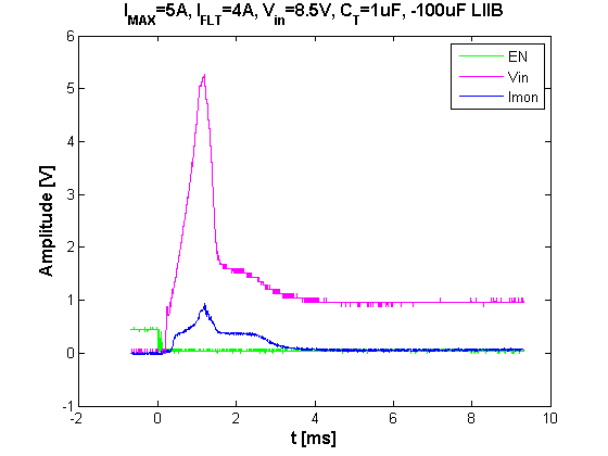

I am using the TPS2420 eval board to verify operation with another PCB designed in-house. This system needs to operate over voltage ranges of 6-8.5 V. I find that my board/load is only able to power on via the TPS2420 from 6-7.7V, while the range 7.7-8.5V results in a FLT signal enable and the chip goes into reset/restart mode. If I start the voltage lower than 7.7V and ramp up my power supply rail connected to the Vin input of the TPS2420, the chip performs fine. Therefore I suspect the TPS2420 is faulting into either the Hard Overload - Fast Trip or the Overcurrent Protection state. My readings of Vin and Imon do not match any of the application plots in the chip datasheet, so it is difficult for me to tell which mode my load is driving the TPS2420 into.
The steady-state current draw of this board is ~0.6A with operational current draw of up to 3A.
The following plot shows a few signals at the vin=8.5V case, which resulted in a fault.

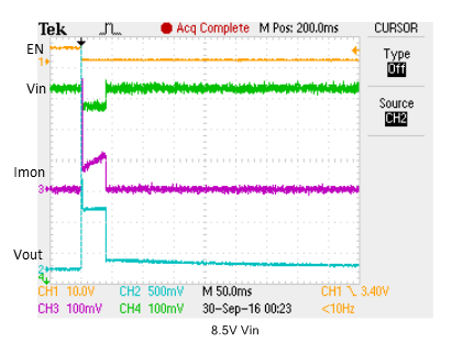

Edit: Here is a long duration plot of the 8.5V Vin case.

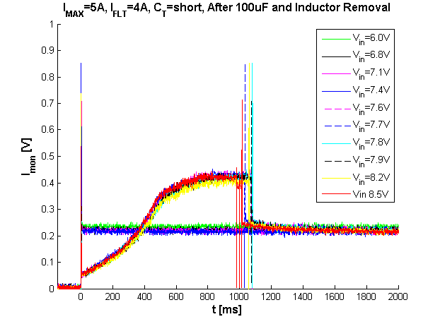

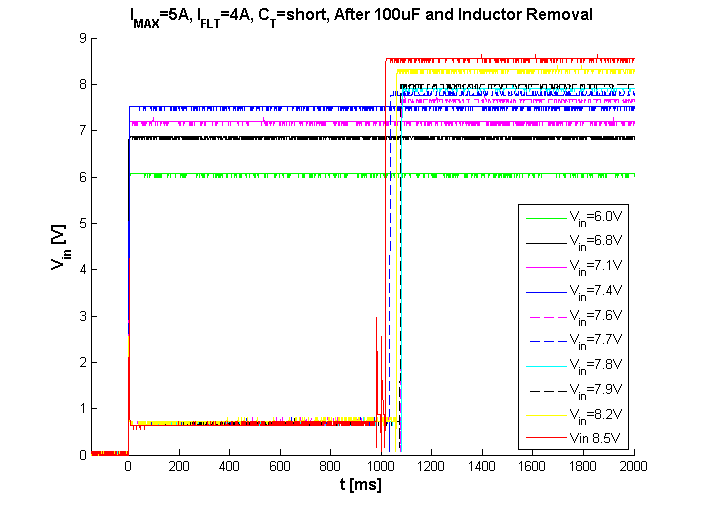

Edit #2: We decided to short the CT capacitor pad in order to bypass the fault detection capability. In addition, we removed our in-line RF bead from the power rail to decrease any inductive loading. We then tested the turn on over the whole range of Vin's. Below are the results for Vin and Imon across the Vin range. With the CT capacitor shorted, the instrument is able to power on within 1050 ms. The cases which resulted in a fault prior to this test take 1050ms to reach Vout=Vin, while the successful "PG" cases from before (<7.6V) reach this state immediately.

    It looks like overcurrent shutdown. The device is ON for fault timer period of around 40ms and then turned off.

    Can you explain what the chip is doing in the first 2ms and then until the 40ms shutdown?

    The behavior is load dependent. In your case, when the device is enabled, it sees current more than the programmed limit. Hence, the control unit starts the fault timer. If the load current remains more than programmed limit for the duration of fault timer 40ms, the device treats as overcurrent and shutdown.

    Why does Vout drop to ~1.5V in the fault cases then? The datasheet does not show a Vout voltage drop (Figure 23) associated with Overcurrent Shutdown. Why is this happening in our case?

    In fault case, the output voltage drop depends on the amount of overload.
    From your test waveforms, it looks the device is entering into power limit mode above 7.7V Vin. The output is around 1V for 1000ms long interval. Unless the add-on PCB is loading excessively, the output should ramp.
