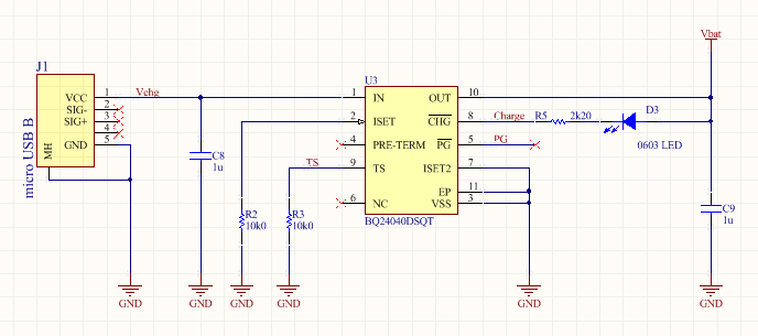

I have designed a BQ24040 charger into our board design. The circuit is this:
I am using a 110mAh Li-Ion single cell battery. I am using my bench power supply for some testing and I can see that the charging current initially starts at ~55mA which agrees with my ISET resistor setting. I can then see the current reduce until it gets to be ~16mA. Once it reaches that level it appears to periodically increase to ~21mA for maybe 1 second and then go back to 16mA. It's been doing this for more than 1 hour.
What could be causing the Charge FET to not turn off?
