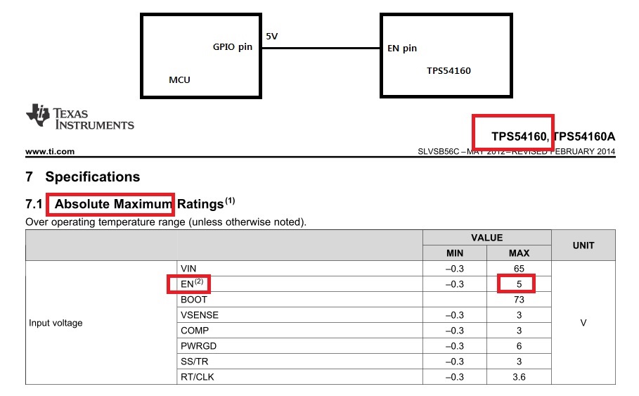

Hi Team
I saw the Abs Max rating for EN pin is 5V.
so really I cannot route EN pin to MCU's 5V domain GPIO pin directly to allow MCU directly enable/disable TPS54160 as below ?
if that, I have two other options; one is to add resistors divider(1/3) on MCU's 5V domain GPIO pin ouput.
and the other is to route EN pin to MCU's 3.3V domain GPIO pin to allow MCU directly enable/disable TPS54160.
please let me get your swift confirm. thanks.
