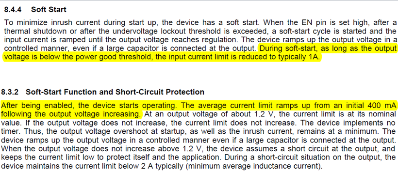

Hi Team,
Our customer would like to know difference in “Method of soft start” between TPS63060 and TPS63070.
My understanding is as follows.
[My understanding]
The control system is the same.
However, I understand that the current limit value during soft start is different.
Is my understanding correct?
And, could you please let us know if you have any information?
Kanemaru
  • Hi Hideto-san,
    the basic priciple of controlling the current is the same. The current is measured on the high-side input FET.
    TPS63070 has an additional feature which reduced the current limit during the soft-start phase to below 1.5A - typically to 1A.
    In addition to the longer ramp-time, this keeps the inrush current low.
    Thomas
